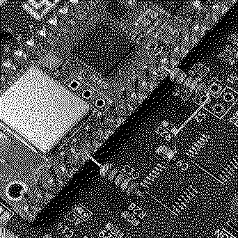

Aug 3, 2025 - #187
I had an unassembled BlueSCSI v2 PowerBook / 2.5 Inch SCSI 2022.11b kit that I finally got around to building (it's going to go in a PowerBook 165c I'm fixing up). I put in a Pico W in anticipation of using the DanaPORT WiFi feature and also did the "wake from sleep fix" for older BlueSCSI boards documented here:
Hardware
BlueSCSI v2 Documentation
bluescsi.com
I had some 1/4 watt resistors that I'm sure were overkill but with some careful lead bending I'm pretty happy how it turned out!
bluescsi.com [View]
IMG_7411.jpeg [View]
IMG_7427.jpeg [View]
IMG_7428.jpeg [View]
