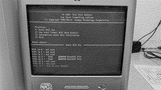

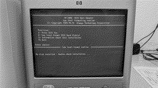

I have been trying to get my BlueSCSI v2 DB25 to boot and I have been having issues to say the least.
My SCSI card is an Always IN-2000 ISA card with Bios.
If I set a blank image as ID0 the bios says it sees a SCSI HDD but using MS DOS DEBUG as the manual says to initialize the image shows nothing but the controller on ID7 found.
If I set the images to ID3 or ID4 for example, the bios on boot up doesn't see the images but MS DOS debug does. When I try to initialize the images, it says it doesn't have a drive connected.
I seem to be in a fun loop lol
SCSI card has termination installed but I haven't tried removing them.
If I try and leave the image as ID0 the computer tries to boot but says "No ROM Basic, System Halted" and all I can do it ctrl-alt-del which then freezes when looking for the disk again.
I'm on the verge of just getting an XT-IDE but I REALLY want to make this SCSI card work. Does anyone have any experience with this issue or a premade image I can try? The images on the BlueSCSI documentation don't seem to be working as it's one of the images I have tried to load.
Here are a few photos of the debug interface:
Any help would be greatly appreciated.
Thanks!

What does the debug log from the BlueSCSI look like?

So here is what I learned. I sat and read the manual for my SCSI controller and it states that you can't skip SCSI ID's, on this controller, you just set the first device to ID0 and the second to ID1, etc. So trying ID3 and ID4 was the reason it was seeing the HD .img files but I could not initialize them and error out.
Next thing I did was try again using ID0 but I ditched the premade images from the BlueSCSI documentation. I found a way to create 2GB image files and after changing the name to follow the BlueSCSI format and making the new image ID0 I booted into my DOS Startup floppy and used the debug command which finally allowed me to initiate the image. So far so good!!!
Next I quit from the debug program and used fdisk to delete the image partition and start a new DOS partition.
Last but not least I used my DOS 6.22 install floppies to successfully install DOS to the newly found C: drive. It asked to format the disk again which took a bit of time but all went smoothly from there.
Looks like we can add a new working SCSI Card to the BlueSCSI documentation!!
