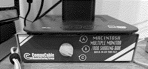

Hey!
I have an old 19" Acer AL1917 monitor that I connect to different beige Macintosh. As far as I understand, this monitor should work at 1280x1024@75.
However, I've always noticed that the VGA connection is strange, the text seems to be doubled or smeared.
Recently, I received a KVM switch that works great, but the problem with the image has become more noticeable.
[Image: KVM1.png] [Image: KVM2.png]
If I set the native resolution for the monitor, it is simply impossible to look at such a screen. This 1280x1024. If I use it without KVM, the image is better, the smearing will be less noticeable.

Looks to me like a shielding issue. Poorly shielded cables or something internal to the KVM box is letting signals hop/bleed. When you hook the monitor directly to the computer, do you see the same ghosting?

So if you don't use the adapter and directly connect your monitor and VGA cable to the VGA output on the KVM, you get nothing?
One guess is that each computer is trying to detect the attached monitor and it is not getting the correct signals. I wonder what it would look like if each computer had the DIP adapter and went to a VGA switchbox/KVM?
