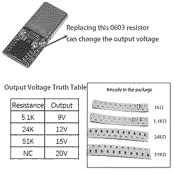

I've been running my 520c off a usb-c trigger board set to 15v for at least a couple days and it works perfectly fine. I had to disassemble the whole thing to get to the contacts of power connector and didn't check if it charges the built-in battery fine. For other devices, it could be as simple as that, or if not - a simple buck or boost regulator could get the voltage lined up. Something more sophisticated could involve a microcontroller, an fusb302, and some mosfets to only deliver power when the requirements are met. That board could also serve as a usb-adb adapter, allowing the use of usb keyboards and mice, and maybe even could have a passthrough for a bluescsi device as a convenient way to transfer data.
Note that a lot of power supplies don't support 12 volts as the PD spec only requires 5v 9v 15v, and 20v, and that usually trigger boards will settle on a lower voltage if the power supply isn't capable of delivering what it asks for.

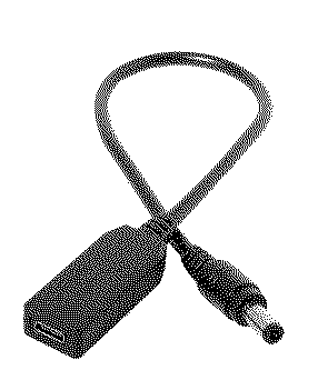

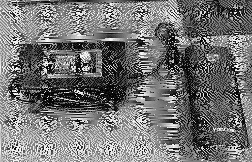

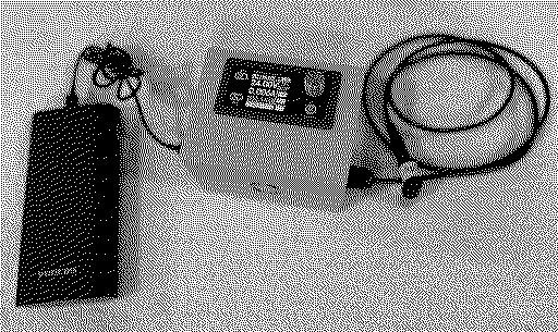

OK, it's not an ideal solution, since it would be relatively easy to make a mistake and send too much power to the wrong laptop, but I was able to make a semi-universal laptop battery solution that works with most of my laptops. Basically, I start with a 20v USB-C trigger adapter ( https://www.amazon.com/dp/B07P81526M?ref=ppx_yo2ov_dt_b_fed_asin_title&th=1) and a USB-C battery pack that can output enough AMPs to keep up for the laptops I plan to power (https://www.amazon.com/dp/B0CHY73CNX?ref=ppx_yo2ov_dt_b_fed_asin_title&th=1).
This gets me a steady 20V output. Then, to get the correct voltage and amperage for the different laptops, I got a buck boost converter that had memory settings for the most common I planned to use (https://www.amazon.com/dp/B09GM73MYX?ref=ppx_yo2ov_dt_b_fed_asin_title).
This allows me to hold down the button for M1 (I have it set to 7.5v / 1.5A for the Mac Portable, 16v / 2A for 5xx Powerbooks (need to find an appropriate barrel connector for these), and 24v, 1.8A for the Powerbook 190, iBook G3s, PB that use the yoyo power adapter). I used some pre-made 5.5x2.5mm barrel jack wires for the output. (https://www.amazon.com/dp/B0CRH9ZVFW?ref=ppx_yo2ov_dt_b_fed_asin_title)

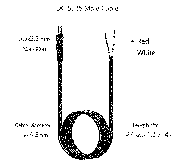

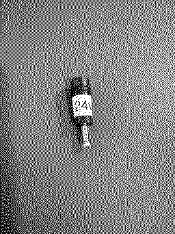

The Portable uses a standard barrel jack, so no adapter is needed. The PB5xx machines use a proprietary connector I haven't found a new part for, and others have cut a connector off their existing, bad power adapters for similar things. But my current 5xx power adapter works, and so I'd prefer to not ruin a good power adapter, so TBD on getting that working. For my PB 190cs, I found a generic adapter in the bag that came with one of my 12v power supplies that measures 4mm OD x 1.7mm ID that seems to fit.. Finally, I found a new adapter for the iBook G3 larger yo-yo connector at Bixnet (http://www.bixnet.com/cntc11.html). The plan is to have adapters that plug into the output of the buck boost converter for all the laptops I would use, label each adapter with the appropriate output voltage to try to make it hard to select the wrong output voltage for a particular laptop.
Basically the adapters look like this with their labels:
Once I have it working well, I'm hoping to either 3d print, or build out of wood, an enclosure to make it a bit neater. Something that the buck boost converter will clip into so you won't see the exposed wires and electronics, but will also hold the adapters when not in use. Then, on the back side I would probably print a label with all the proper voltages for the various laptops. I'm hoping with that battery pack I can get a few hours of runtime on many of these older laptops. I'll try to make some progress on testing the setup and confirming usability and runtimes.

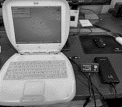

Here it is running my lime iBook G3 with not battery installed:
The part that isn't ideal is that the tip usage and the voltage setting being independent and therefore open for a possibility of the wrong voltage going to the wrong adapter. An ideal solution, if I had the know-how, would be to have a knob with settings for different laptop types, and a set of output cables. When the knob was set to a specific laptop, only that one output cable would be activated and always with the correct voltage. But, I think that would require a custom PCB, custom controller for the buck and boost converter to manage the settings, something I just couldn't manage without an EE background. So I'll have a bit of a janky solution that allows me to avoid nearly burning my finger off trying to rebuild battery packs... I also prefer a solution that leaves the laptops in their original state, as much as possible. I think this will accomplish that goal.

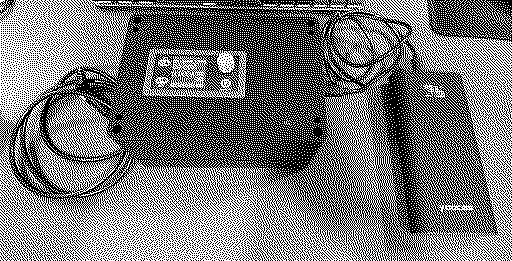

My 3d printer is acting up, but I realized I have a plastic project box I never used and bought a panel mount USB-C port, cut some holes in the box, and put most of the stuff inside.
The box is comically large for what I have inside, so I'll address that when I make the printable box for everything. I also will address the need to ventilation for the buck / boost converter. It has a fan, but the box it is in has no vents, so I'll add some vents on each side to improve the airflow if running this for a while.
The other thing I might try to do is to have an alternative bottom that allows for my battery pack to slide in while in use. I think it would be nice to have it be self contained. Obviously that means if this battery pack stops working, I'd have to redesign the thing. So I'll probably just stick to a smaller box with usb-c input so it will be able to be used with any USB-C power source. Battery or AC adapter. This would allow it to be used as a replacement AC adapter for my laptops as well.

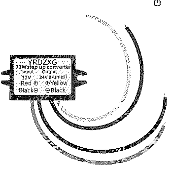

It does feel like the 24v to 20v may be too much of a gap. I think I may make a cable with the 12v trigger and a 24v booster inline. That will allow it to still be pretty discreet, but get me, hopefully, the stable 24v that will work best. I will still use interchangeable tips for the various laptops that used 24v.
For those with EE backgrounds, would I be better to use a trigger set to 12v or 15v with this 24v step up converter. The converter says it can handle 10-19v input. Would stepping up less in voltage allow it to be more efficient (less waste heat, lost power)?

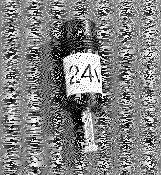

FYI, I've pivoted from using the universal voltage adapter because of the size and the pain of switching voltages, and have gone to building voltage specific versions of @PotatoFi's Powerbook adapter found here:
I have 4 adapters (soon to be 5): 7.5v, 16v 24v for the Mac laptops. Also build a straight 15v pass through (no boost converter) with a custom connector for my Apple IIc. Soon I will be creating a 12v pass through which I will be able to power my Apple IIc where I replaced the PSU with a PicoPSU.
