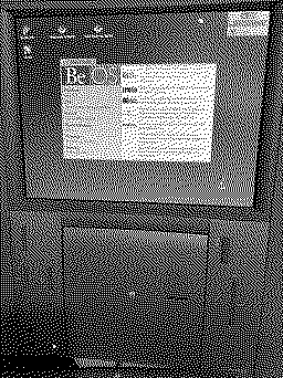

Getting some issues with it hanging on some boots from the blueSCSI. Not sure if it's an issue with the blueSCSI, the image, the scsi on the TAM. But here is a picture as proof.

That's very frustrating (for me). Your screenshot says you have a 250MHz system with 64MB of RAM. Any L2? I have a 6500/275 with 128MB of RAM and 1MB of cache, so I need to narrow some of these issues down. Maybe there's a logic board difference.

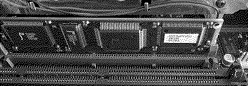

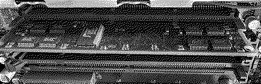

Couldn't figure out the l2 cache size in software. But took some photos of the board installed into the cache slot.
Did a search on the part number on the underside of the cache and it looks like it's the stock 256k card that I believe came with it.
