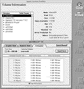

Jun 20, 2025 - #14
Finally, it's time when I can share the results of this card on the Macintosh Quadra 950.
Disk subsystem performance when using the stock processor 68040 33 Mhz
Disk subsystem performance when using the Apple PPC Upgrade card 66 Mhz
On average, SEIV increases the performance of the disk subsystem by ~1.5 times, which in my opinion is a good result. But I'm surprised! I was sure that PPC would add performance, but we have what we have.
The same circuit with adapters that I described above is used for connection.
SE IV works without extensions and allows you to boot into any OS. I tried AUX, SSW 7.0.1, MacOS 8.1. I haven't tried booting in Mac OS 8.6 yet, it's installed in the BlueSCSIv2 Desktop image, but most likely there will be no problems.
Now I'm thinking about how to place the SSD inside the Q950 case. :unsure: I'll probably write about it in another topic.
Q950-68k-SEIV-SSD.png [View]
Q950-PPC66-SEIV-SSD.png [View]
