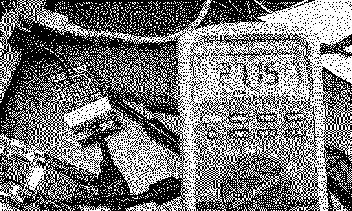

To measure current, I purchased an S-Video splitter from Amazon (https://amzn.to/44O361f). S-Video uses the same 4-pin mini DIN connectors as ADB. A splitter includes both male and female connectors and a short length. This allows the test device to be plugged into the female end of the splitter, with the male end connecting to the Mac, while keeping the tester's cable length relatively short.

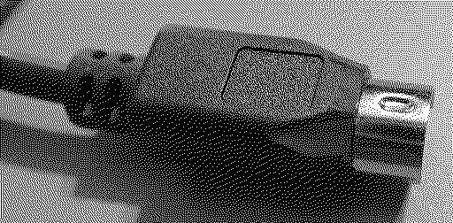

To access the wires, I cut the splitter about halfway on the male end. As the wire colors have a different meaning on S-Video, I needed to tone them out to determine which ADB pins they connected to. Annoyingly, on this particular cable, red=data, green=gnd, black=power on switch, gray=+5V, and bare copper is for the shield.

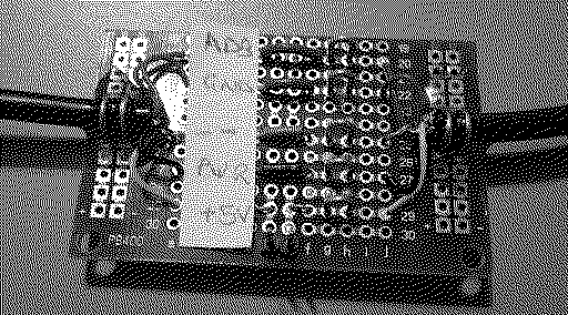

With this knowledge, I inserted a scrap breadboard PCB between the cut ends of the wire.
All wires except the +5V wire are simply connected across (with a nice little loop for attaching a multimeter hook). The +5V wire goes to a two-pin header. With a jumper attached, the +5V goes directly across. Without a jumper, a multimeter can be inserted to measure the ADB device's current.
(Although both female ports work on the S-Video splitter, only one is used during current testing to avoid reading the current of multiple devices. Also, make sure you have the multimeter in DC current mode, not AC.)
The cable ends are secured with loops of soldered wire and some epoxy.
The male S-Video connector does not quite fit into the ADB port of the Macintosh IIci. Snippers trimmed the square corners off the S-Video connector to allow it to be fully inserted.
Current Readings

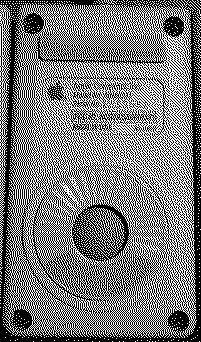

On the original series of Apple Desktop Mouse models (before Apple Desktop Mouse II), the underside label includes a circle with a flat spot to indicate which mouse model has low-power usage.
I was pleasantly surprised that Apple was absolutely honest about the difference in power usage. The original mouse uses 70-80 mA (350-400 mW) but the low power models used only 5 mA (25 mW)!

Although Apple kept the same product name and model number for the Apple Desktop Mouse it actually went through a series of changes. For example, the low power revision and the change from a large gray heavy ball to a smaller lightweight black ball. I did not open the mice to inspect the boards, but other sites have reported many revisions to the internal guts.
The first ADB mouse series was produced in at least three countries (USA, Malaysia, and Tawain). The Apple Desktop Mouse II was produced in at least Malaysia, Tawain, and China. Perhaps Puerto Rico as well.
The labels and ball covers changed over the years, despite keeping the same product name.
It would be fun to determine the actual release order of these mice. Perhaps the original Macintosh manuals / user guides describe how to clean the mouse -- which might provide clues as the mouse variant at the time. For now, below are the variations in my collection.
If the serial number is to be believed, I assume the black retaining ring was produced earlier than the gray ring.
Now we move into the lower power models. The Macintosh Portable model is not shown, because I don't have one. But, after that, a fair guess is the ribbed retaining ring with a low power symbol was produced next.
Then, a lot more industry standard marks appear on the label. The retaining ring switches to a push down arrow. But, the mouse ball remains gray, large (25 mm), and heavy.
Finally, the dreaded lighweight black ball.
