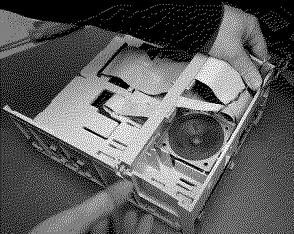

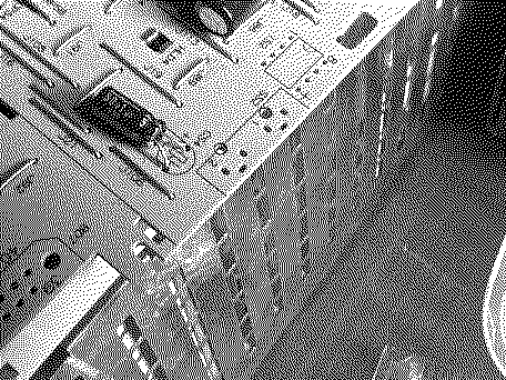

It is however very interesting to see what Apple Original design was. This is the connector location on the AB
It is connected to the first TDA audio amp IC (you can see the footprint) that mates with this header on the electronics cage:
and from there obviously to a twisted pair that went to the loudspeaker below. And to answer the question above - exactly because Apple does NOT build loudspeakers, it is unthinkable that they decided to use another one inside if it was not for some problem that could not be solved otherwise. Maybe a regulatory or certification problem rather than of functionality.
