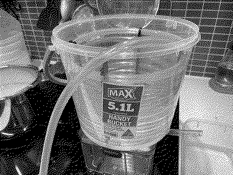

There are purpose-built devices for this, but I decided to "MacGyver" my own from household stuff. I used an off-the-shelf kitchen pressure cooker (the most expensive item in this build at $70 AUD), 5 metres of 8mm vinyl hose for $18, and a 5 litre bucket for $4.50. $92.50 all up.
I started by drilling a hole near the bottom of the bucket. The bucket would serve as the holder for the coiled hose, as well as the cooling system, by filling it with water (the faster you can cool the alcohol vapour, the faster it will condense into a liquid and less will be lost into the atmosphere). I fed the hose out the hole in the bucket and then sealed it with some hot glue.
Next I 3D printed four holders for the pipe. These would keep the hose arranged as a coil, so that the distilled alcohol could flow down and out the end of the pipe.
The pressure cooker I purchased has a safety vent in the middle of the lid. By a stroke of pure luck, that vent is the perfect size for the 8mm hose I had (I purchased the hose first).
So, the cloudy alcohol goes into the pressure cooker, gets brought to boiling point, the vapour comes up though the vent, into the hose and then through the spiral cooling system. It condenses into a liquid and collects into a receptacle at the end of the hose for re-use. It's simple science, and it works.

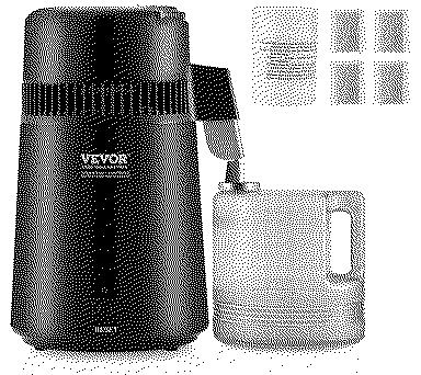

Great reference for beginners! I purchased a purpose-built distiller to do this myself. The results are perfect ... but good lord the smell of the distilling isopropyl is overwhelming.
Definitely recommend some distance from people and structures - if not for the fire risk then for the overpowering smell.

>> Stephen said:
Great reference for beginners! I purchased a purpose-built distiller to do this myself. The results are perfect ... but good lord the smell of the distilling isopropyl is overwhelming. Definitely recommend some distance from people and structures - if not for the fire risk then for the overpowering smell. Click to expand...
What sort of distiller are you using? Can you please post a link?

Nov 5, 2024 - #5
>> Branchus said:
What sort of distiller are you using? Can you please post a link? Click to expand...
This is the specific distiller I bought but there are many like it.

Nov 5, 2024 - #6
I very nearly bought one like that but opted for a larger unit. I now regret my decision.
