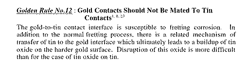

Not sure why, but he seems one of the only RAM sellers who chooses to use gold plating, which I really like. Click to expand...
Probably because it's not a good idea with tin sockets:
I read something similar in an Apple document, but I can't remember which one at the moment.
1766199246087.png [View]
Dec 20, 2025 - #19
@YMK
Oh, I did not know that. Very interesting. It makes you really think more deeply about gold contacts.
But of course, many commercial connectors have long mated gold-plated pins to tin-plated sockets, and those devices have worked as expected for decades. I suspect there are many factors at play here, such as how thick the gold plating is, the insertion force and scraping, vibration and temperature, electric current passed through the connections, etc. It's not clear how much the scraping of the gold comes into play because gold is a very soft metal.
Gold-to-gold might be better in theory, but when you repeatedly insert and remove, that scraping can wear off the gold in spots over time.
I guess it boils down to practical experience though. How many devices have failed due to gold-on-tin contacts? And can we argued from an informed position that gold contacts on RAM SIMMs would be inferior in actual practice.
Would love to read that Apple document you mention, should you ever find it. Might prove to be an interesting read.
Thanks again for bringing this to my attention. I don't think it necessarily undermines the designs created by Dr. Antoine Bercovici (SiliconInsider, creator of that purple, gold-plated RAM), but it might be nice to hear his opinions too.
Dec 20, 2025 - #20
Continuing my investigation, I spoke with someone moments ago who said that he estimates 10% of 30 pin modules from back in the day are gold plated and possibly 50% of 72 pin modules are gold plated. He went on to say that very few sockets are gold plated, and yet over the last 40 years, we've not seen catastrophic failures of gold being matched with tin.
Even from back in my engineering school days, we were taught about the surprising differences that one can find between the theoretical and the experimental. So we could chalk it up to that, especially because there are many factors that come in to play.
But I suspect that most modern vendors of RAM SIMMs are avoiding gold, not because of the discussion that we're having now, but simply because it's more expensive.
Of course, I'm not disagreeing with the theory and I still appreciate it very much. I always like to be informed. And I still would love to see that Apple document someday. But for now, I have vintage machines with the aforementioned RAM working well and I'm not too deeply concerned about it.
