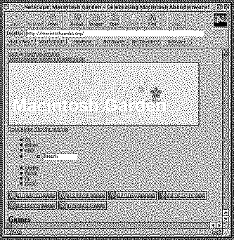

I believe I fixed that years ago, while access is possible it doesn't look very pretty at all
Screenshot 2023-04-09 at 11.34.38.png (16.8 KB)
Apr 9, 2023 - #3
Functionality over eye candy. :)
So, the user-agent string isn't needed as the site is already set up to accept Netscape 2.x, correct?

Functionality over eye candy. So, the user-agent string isn't needed as the site is already set up to accept Netscape 2.x, correct? Click to expand...
That should be correct, though if you run into a 403 error with a vintage browser, do let me know ;)
