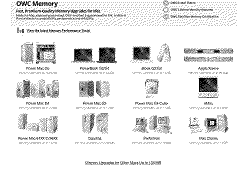

By the way, OWC still sells RAM at macsales.com for legacy Macs: https://eshop.macsales.com/shop/apple/memory/legacy
I just picked up enough RAM to max out my SE/30
1632584472497.png [View]
Sep 25, 2021 - #4
While this is true, the 30-pin SIMM's available from there and Keystron (https://keystron.com/) won't work in a II or IIx still - hence the need for these ones.
