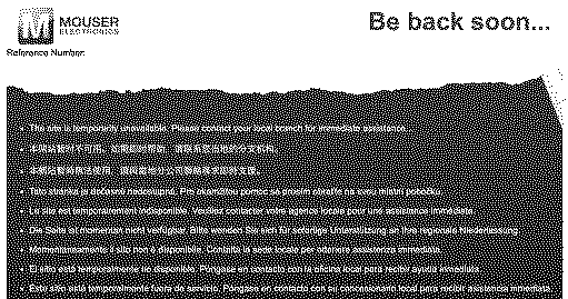

I was trying to swap out capacitors in my two Carts after reading your post, but suddenly the entire website shutdown...
I guess I will need to wait until tomorrow.
Tariffs have wreaked havoc across all my Mouser Carts, I must say. It's very frustrating.

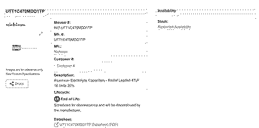

The website is working here in the US. But restrictions showing up James.
Screenshot 2025-10-02 at 1.05.15 PM.png [View]

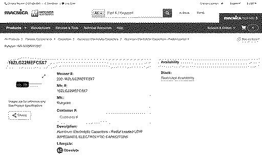

The site is working today, but even though I have the site set to the Japan region (where I live), I am getting the same message...
That indicates it may not be sold anywhere, which is very odd.
Swapping out the caps is going to take time because the ones in my cart originally were the best caps available at the time. Now I am finding inferior ones. They will work, but have higher ESR. For example, consider the specs of one of the 22uF caps in my 400K Drive OA-D34V-22 Cart, with ESR of 270m-Ohms and 350mA Ripple Current:
An in-stock 22uF cap with the same physical size and lead spacing and capacitance has higher ESR, as evidenced by the tiny 50mA Ripple Current:
Sometimes choosing a higher voltage cap will reduce the ESR, but there is an upward limit to that because there will come a point when you won't be able to find a cap in the physical size you need, and if the cap is too big, it won't fit. That's why it takes time to find good replacements. You need caps that fit into the space on the PCB, have the right lead spacing, and also have good specifications (105*C, low ESR where possible, etc.).

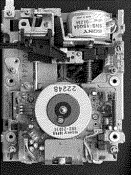

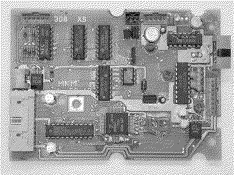

I did take one 400K external apart far enough to see boards to some extent.
IMG_6388.jpeg [View]
IMG_6389.jpeg [View]
IMG_6390.jpeg [View]
Oct 7, 2025 - #9
Capacitors for the LARGE PCB are the same across all 400K drive types. Only the SMALL PCB have differences.
Your photo of the SMALL PCB matches my photo here...
[Image: 400K_SmallPCB_Type1.jpg]
That is a good thing because I am worried about the other version SMALL PCB where you must put one of the capacitors on the left side, and there's no space to lay that capacitor down on its side. But you don't need to worry about that because your small PCB has only 2 caps on the side. So all should be well.
