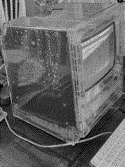

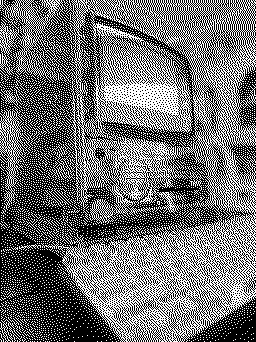

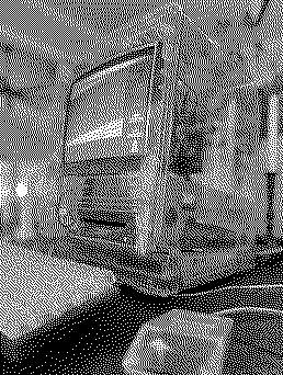

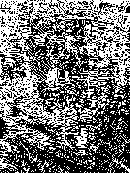

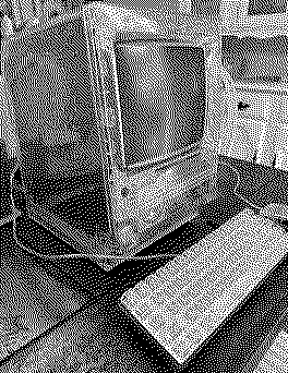

I received my MacEffects case yesterday. I'm so glad they did another run of the clear because I always loved the look but missed out on previous sales. I've had an SE/30 with a reloaded board I've been keeping around with the intention of putting it in a clear case if I ever got the opportunity. So, here's some photos I took of my newly assembled SE/30. Paired it with the clear mouse and clear Design68 keyboard I built specifically for this machine.
[Image: IMG_0818.jpeg][Image: IMG_0834.jpeg][Image: IMG_0836.jpeg][Image: IMG_0838.jpeg][Image: IMG_0839.jpeg][Image: IMG_0843.jpeg][Image: IMG_0855.jpeg][Image: IMG_0859.jpeg][Image: IMG_0862.jpeg][Image: IMG_0864.jpeg][Image: IMG_0867.jpeg]
Now I need to start saving up to add upgrades to this machine, like grayscale and maybe an accelerator.
And thanks @MacEffects for all the awesome products you've made for the Vintage Apple community!

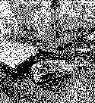

I just received my MacEffects case TODAY! I previously received the programmer's switch, mouse, and speaker. I am really looking forward to transferring my restored SE/30 into the new shell. Your's looks great, especially that keyboard! Here's mine fresh out of the box!

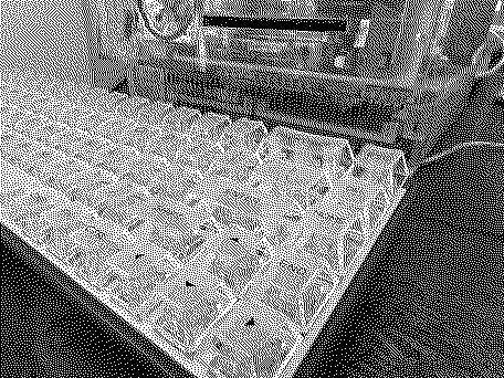

Question @wottle how did you do the silver/clear cord on ADB mouse? I assume it's from another device perhaps? Was there already ADB (4-pin DIN) connector or did you find an S-video cable, or put together your own connector?

So, I ended up making my own. I found a clear sheathed S-video cable, but it was too thick for use with the design68 keyboard. I found some clear cables on aliexpress that worked for both the mouse and the keyboard. I then used some s-video mini-DIN 4 pin connectors for the other ends of the cables.
The details of the parts I used can be found in the design68 keyboard thread. https://tinkerdifferent.com/threads...using-appledesign-controllers.2952/post-38290
Also, there is a post from earlier in that thread where I talk about the other parts I used (clear keycaps and clear key switches).

It's a Design68 keyboard. This one is a bit modified from the original design to use a slightly different variant of the case. I go into the details in this post: https://tinkerdifferent.com/threads...using-appledesign-controllers.2952/post-36774
But, I would recommend sticking with the stock CIY Tester68 keyboard that the creator recommends. Using the Novice68 keyboard required a good bit of hacking and it's not nearly as easy or clean, and I don't think it actually makes that much difference. I originally wanted to try the Novice68 because it had a more translucent case, and it had extendable legs. The legs are nice, but you barely notice the translucence of the case itself. It's not worth the hassle, in my opinion.
However, I do really like the clear cables I used for the mouse and the keyboard. I'd recommend switching them out if you can.
One thing I really wish I had tried to do is see if I could have gotten a laser cut clear acrylic in the right thickness to use as the mounting plate. Mine has a white mounting plate, but I think it would be really cool to be able to see the Design68 PCB through that top plate.

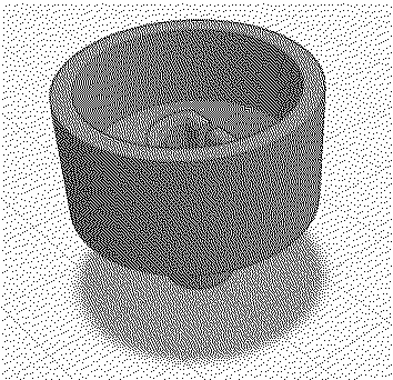

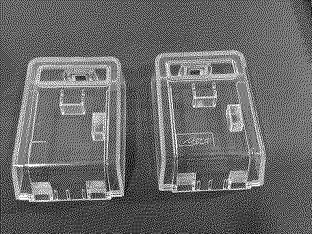

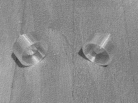

Would people be interested in a group buy (at cost) for clear resin version of these adjustment knobs? it looks like I could get them for around $3 each if I ordered 10.
I have a combined model that should print OK in resin. I'm going to print a couple out and see if they fit ok in the MacEffects case. Also, @caver01 , are you OK with me doing that? Not looking to profit, offering at cost, just trying to help people out that don't want to order their own from a resin printing service.

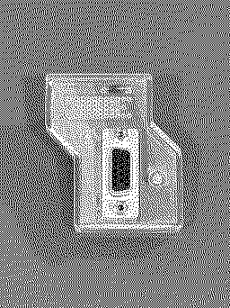

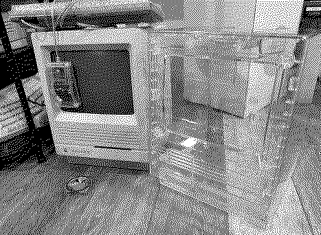

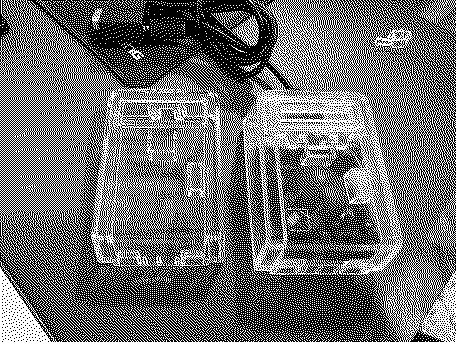

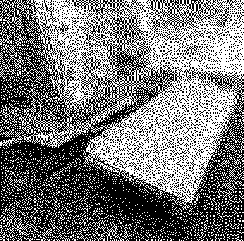

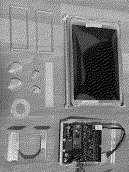

since you guys are debating clear parts I'll share how mine turned out. zigzagjoe printed them for me (I paid for the spool of clear filament) when I bought his color LCD kit, all of which are going in the clear SE/30. my case is scheduled to arrive tomorrow, but I need to recap the SE/30 and do some other things before the swap.
LCD mount and bezel
RAM SIMM clips
ROM SIMM clips
Speaker ring(?)
Fan mount
Rear access panel
Brightness knobs
BlueSCSI mount which fills the floppy slot and puts the SD slot there.

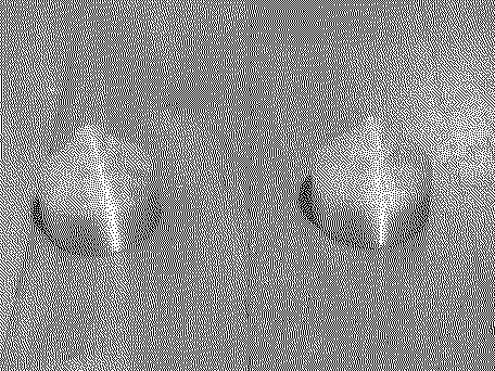

since you guys are debating clear parts I'll share how mine turned out. zigzagjoe printed them for me (I paid for the spool of clear filament) when I bought his color LCD kit, all of which are going in the clear SE/30. my case is scheduled to arrive tomorrow, but I need to recap the SE/30 and do some other things before the swap. LCD mount and bezel RAM SIMM clips ROM SIMM clips Speaker ring(?) Fan mount Rear access panel Brightness knobs BlueSCSI mount which fills the floppy slot and puts the SD slot there. View attachment 21868 View attachment 21869 View attachment 21870 Click to expand...
I highly recommend trying clear resin prints if you want to match the clear MacEffects case. I printed the mouse in my photos using JLC3DP. It's not perfect, but it will be better than anything you can product using a filament printer. By a lot.
I've printed clear cases for my HDI-45 adapters as well as recreation Lisa mouse enclosures.
