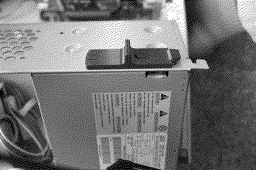

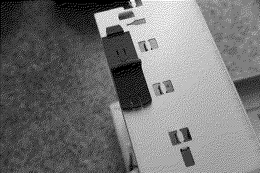

I have a Power Macintosh G3 in and the plastics are very crumbly, so i have spend a few hours to make the needed parts in CAD and i have test fitted them. a few revisions down the line, they are ready to print.
Here to share:
- HDD slide in brackets (the ones that live on the metal frame)
- Slide lock to lock the swivel frame in place
- HDD bracket for mounting to the drive

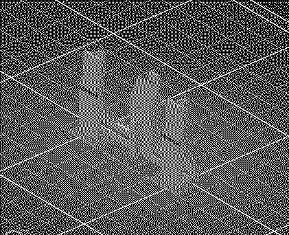

0.4mm nozzle, 0.1mm step height, ideally PETG material print with supports. please check slicer image for best print orientation.
Happy printing!
Arjen.
Power macintosh G3 parts.zip (137.4 KB)
Slidelock+brackets print oriontation.JPG (334.1 KB)

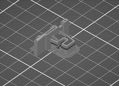

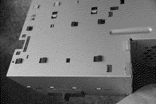

I have also drawn up the Motherboard supports and the Motherboard clasp as they are also crumbly
print with 0.4mm nozzle at 0.1mm layer height out of PETG material
Powermac G3 mobo clasp.JPG (185.4 KB)
Powermac G3 Mobo support.JPG (103.2 KB)
