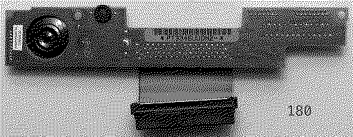

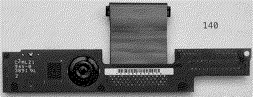

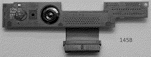

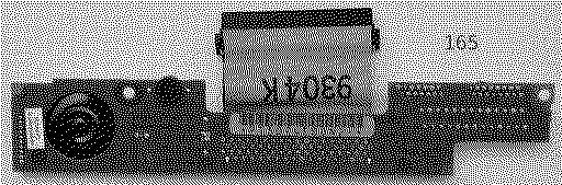

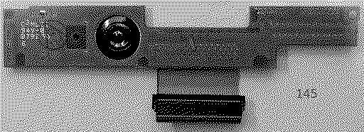

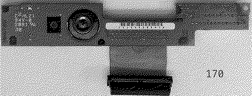

I *believe* the 140/145/145B/170 ones are interchangeable, and the 160/165/180 ones are interchangeable. The relevant difference being a 60 position connector / cable vs 72 respectively.
Some photos for comparison:
I've done some very casual looking into creating new assemblies, but searching for new IDC PCB connectors with the same pitch / arrangement has been fruitless. You can reuse the existing connector with a new cable, as demonstrated here: https://68kmla.org/bb/index.php?threads/how-to-repair-a-powerbook-140-180-interconnect-cable.46387/

Sep 11, 2025 - #7
Long time getting around to it, but an update regarding the 180:
This was fixed (today) by transplanting the interconnect board from a PB160, which was non-functional anyway. The 180 is finally back up and running happily - aside from the almost inevitable tunnel vision, but even that doesn't really start until an hour or so.
I did cross-check the 165c and 180c interconnect boards - they look interchangeable with each other, but are not compatible with the 160/165/180.
And in the process of doing this, I discovered where my missing BlueSCSI went - I had already installed it in the 180.... doing which was probably what damaged the interconnect!
